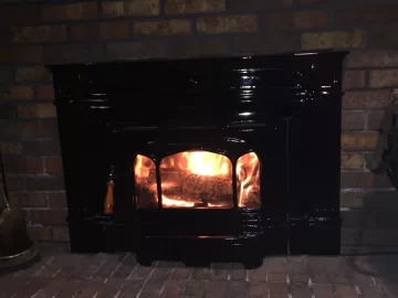

I have a couple of things I would like to run buy the team here. I have purchased a used Hampton HI200 in Timberline Brown. The unit is in really good shape and was manufactured in 2008. Here is the set up.....
Insert - Hampton HI200
Location - Existing Basement masonry fireplace with proper clearances
Chimney - 35 foot, exterior chimney with independent flues (upstairs/downstairs)
Flue - 13x13 Terracotta clay liner in great shape
Liner - Looking for a 35 foot insulated liner but I am not sure which one to get. I have a local guy selling a 35 foot, new Z-Flex liner with blanket insulation installed. Chimney cap, and appliance adapter for $500. I would have to get a proper terracotta top plat. But that seems like a good deal. There are many other sources but I am looking at $1100-$1300 for the liner.
I had two chimney companies come out today and I am waiting on the quote for install but I am really having a hard time not trying to do this myself. One stated that I do not need to insulate the liner, but I feel that we should. 13x13 is a pretty good size space to stuff a 6" insulated liner and although it may not be a straight down, I feel like I could do it. However I want it done right......![Smile :) :)](/talk/styles/default/xenforo/smileys/grin.gif)
I believe that I will have to somehow remove the damper frame but I need to get in there to see how hard it will be to fit the liner through.
Can you guys give me some advice on the liner and whether or not I should install it myself? Anyone in Maryland want to assist for a nice bottle of bourbon or beer and good company!
