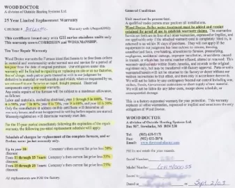

OK . . . here goes nothing!
Have you notices the phrase in your Wood Doctor warranty, "on site or at our factories"? :-/
Returning "a part" to the factory when requested by Wood Doctor may not seem like a biggy, but what if Wood Doctor considers "the part" to be your entire 2000 lbs furnace and what if you live in Nova Scotia and "the factory" is in Manitoba? :bug:
I am the not so proud owner of my second 2000 lbs stainless steel exterior wood furnace. My original furnace developed perforations in it's belly causing it to loose all it's water in only it's second heating season. I managed to make it to spring by holding vigilance over ten or so pine plugs hammered into the holes to stop the leaks!
This first boiler was promptly replaced under warranty by Wood Doctor at virtually no cost to me. :-)
This replacement stainless steel boiler has now just barely made it threw it's third heating season this time developing perforations primarily along the belly weld lines! :red:
My original furnace has a 25 year warranty covering repairs at 100% for the first 5 years. I am still within the first 5 years of my warranty and have had two of these boilers corrode out on me.
This time around though, Wood Doctor is exercising a phrase in it's warranty which they believe gives them the right to request that I ship my entire furnace half way across the country for assessment to repaired or replaced rather then they send someone local to fix it. It is simply ludicrous to me that they believe they can interpret their warranty in this way, making it, in fact, no warranty at all! Their interpretation is essentially that an entire 2000 lbs furnace is a "part" that they can request be returned to them for repair! :sick:
I've stuck epoxy putty over all the holes in my Wood Doctor and put it back online for this heating season, but I have no idea how long it will be able to hold water! I do not seem to have much choice at present! :down:

Did you discuss the freight issue with Wooddoctor? The warranty states freight is pre-paid. I assume they will offer to pay the freight from your home to their factory. If they do this they are following the warranty. I'm not sure you have much of a position to argue with sending it back if they offer to pay the freight.
For the record that warranty statement is not at all unusual. Nor does it seem particularly unfair. Manufacturers usually reserve the right to determine whether defective products are to be repaired or replaced. In my experience they also prefer to have you send them the parts to do this analysis in their own labs. Just my two cents...
