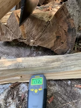

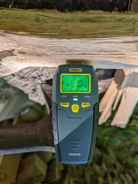

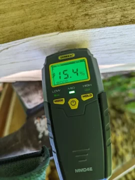

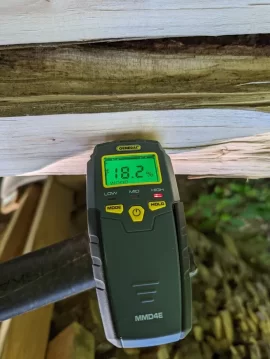

I was out back doing yard work and decided to test this year's wood so I grabbed the biggest easily accessible split I could from each rack. All 2-3 year old red oak and red maple. I love being prepared!

Red oak sure does make some excellent firewood. Nice work OP!
Indeed a nice sight!

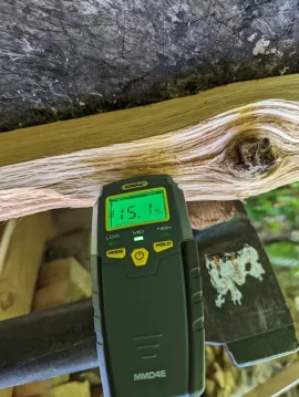

For the urban burner short on space don’t ignore the short seasoning time of softwoods. Sure it’s not going to get you an overnight burn but hot and fast is still heat. Had to look back this was split 13 months ago. Not gonna wait 3 years to burn this!

You can get an overnight burn with soft woods also if your firebox is large enough (and depending on how long your night is supposed to be...).
With my 2.9 cu ft firebox, I can easily get an overnight burn, i.e. 8-10 hrs on pine is no problem. And not only when running "low and slow", but in the medium output range as well.
The bigger danger with pine (vs oak) is that if you're an hour late to check on it (basement stove), there can be *very little* coals left. Being late with oak is not an issue, as the coals survive for a few hours longer.
I posted a few weeks ago that the pine I split and stacked in what I think was March, is already below 20% too. It's nice. If one has a cold winter, and one burns a bit from next years' stacks (I am on a 3 yr rotation), it's easy to refill that to be full again in spring with pine - it'll be okay that winter.
