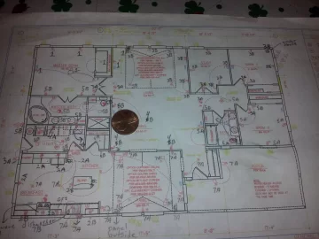

If you are using that area as a dining room, as the plan suggests, I think a stove at that location will take up a lot of room for clearances. I'd suggest setting a few chairs to designate the area the stove will occupy plus the hearth in front of it. If that space is not intruding in your activities, go for it. Remember, with a stove on, you really would not want to sit too close to it.
Ditto that thought. Any chance you could move it to the other side of the room nearer the porch entrance? That'll be easier for moving wood in to feed it anyway.
The space proposed for the stove can't be the dining room. There's no direct access from the kitchen into that space. My guess is that the dining area is directly to the right of the kitchen as shown...completely open.

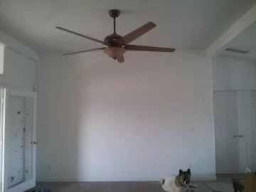

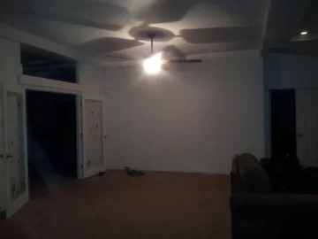

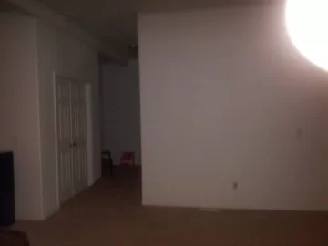

Thank you guys very very much.for the input so far. I am going to try to answer all the questions ( I hope) I live near Tracy CA so it is mild or very warm compared to where some of you live. My house is all electric and my heater draws 120 amps so due to my pge bill being over $600.. that was with the heater at 65-68F This must be my only source of heat for the winter... Id like a stove that i can fire up at anytime. Also i would love to run it all night with out any issues The dining room and living room together are what we call the living room. ( so at the moment the dining room on the floor plan is just empty space)t The glass door you see goes into the space next to the kitchen which will be our dining room, B ed room 3 is the most important to me this is where my 6 month old sleeps and i would love to keep that room at a nice temp. My house has vents in the ceiling linking the bed rooms and study to the main area. ( im not sure if that will help) Is that also the non-cat stoves that have to have wood that is less than 20% moisture also? I really appreciate the help this seems like a project that really has to be done right the first time... (the first picture is the wall i would like the stove on. the second is a view but the hall way and the last pic is close to the wall where the stove will be for the view of the hallway. sorry about the quality.)
