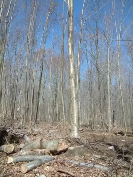

YB grows over a fairly wide range, but it's mostly concentrated in the more northern areas. Those of us in New England, New York, parts of Pennsylvania, northern Wisconsin and the U-P have the most chance of finding it. Attached is a pic from the woodlot I'm thinning. In PA they call it "black birch" but it's basically the same stuff.
