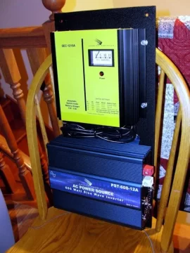

Well its the 2009 heating season and i'm ready to finally hook up my battery backup with Optima deep cycle battery. Here are a couple photos of the setup. Looking back, I should have bought an inverter with built in charger and transfer switch. The setup I ended up with is bulky, but it will be on a wall that won't be out in the open.
  • [Hearth.com] XXV INVERTER
