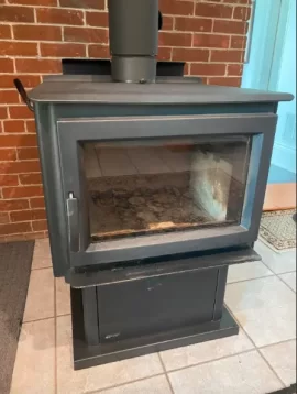

Have been getting a bunch of quotes and came across a F3500 about an hour from me for $1100USD, I have been leaning towards the summit and princess and still waiting on the princess quote. It looks in pretty good shape and sellers said they redid the area and it has been putting out too much heat. I asked about the mark on the top left corner of front which looks like a crack but assures it is not.

Looks like a crack on the face top left corner of the door opening. If so no don't get it. Otherwise it's a great price.
Reactions: EbS-P
It definitely looks like a crack to me
Now Regency does have a lifetime warranty on the box. Unfortunately it isn't transferable. There is a chance you could get them to honor it but I wouldn't take the chance
If it is a crack they were probably running it like a freight train full speed ahead and overfired it
Or a flaw in the metal that was missed it happens occasionally. I would normally agree with you but I don't see any other signs of abuse
I didn’t see any other signs of abuse either and I wouldn’t be afraid of drilling a hole in the end of the crack, grinding a “v” in the rest and welding it closed, smooth it, paint it, enjoy the fire.
Yeah but I would try to get it for less if that's the case. I have seen to many fail after doing that to take a chance on $1100
Reactions: Hoytman

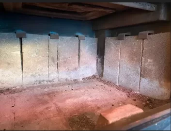

Agreed, it sure looks like a crack. The paint on the face is greying. It could be that the stove was pushed too hard. This could be due to a tall flue on the stove or user negligence. The firebricks are cracked in the back which indicates wood was probably thrown in the stove instead of being placed and not slammed against the back.

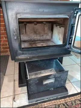

Possible crack on bottom right of door? hard to believe there would be a crack there but in the pic it kind of looks like one.

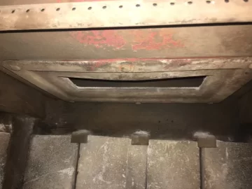

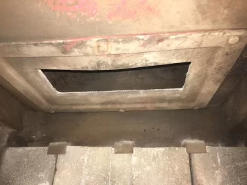

No cracks, the damper housing has a good bit of sag to it, not sure if that would effect the ability to fully close it off?
Markings are all gone off the catalyst engagement thermometer.
[Hearth.com] Would I be a fool not to pickup a Regency F3500 that needs catalyst for $1100USD?[Hearth.com] Would I be a fool not to pickup a Regency F3500 that needs catalyst for $1100USD?[Hearth.com] Would I be a fool not to pickup a Regency F3500 that needs catalyst for $1100USD?
Good deal for checking. That's going to affect the damper seal. Looks like another sign of being overfired. Deduct the price of a bypass frame and gasket.
Was the stove on a particularly tall flue system?
Its a two story house so had to be pretty tall, I didn't really pay attention though. Trying to locate a price on a new damper assembly but no luck yet.
