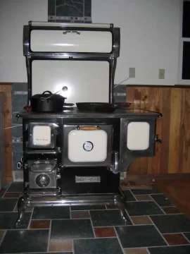

I bought a Heartland Sweetheart (used) this past winter for a steal of $1000, so I will have a separate cookstove running in tandem with my Hearthstone Mansfield. I plan to do the install this summer/fall.
BTW, Hearthstone also started making a cookstove (the Diva), possibly put out more heat than Heartland line? I didn't see this one mentioned.
When I do my timberframe addition in a couple years, I am planning to plumb up the Heartland for some supplemental hot water.

Mike from Athens said:
I bought a Heartland Sweetheart (used) this past winter for a steal of $1000, so I will have a separate cookstove running in tandem with my Hearthstone Mansfield. I plan to do the install this summer/fall....cut, snip....
Oh you lucky dog! What a find... I know the Heartlands are EPA exempt, but I wish they'd get them tested anyway, so we could make an informed choice...We so love the look of it.
