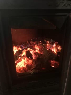

Here’s my morning update. Fully loaded (to the max) at 8:30 pm, damper fully closed, cat engaged at 500 degrees, and left for the night. Now 7:30 am, pictures attached of stove temp and coals. Wondering if any other PH owners are seeing the same results with less wood? I’ll be testing more after the holiday weekend.

That many coals would be hours more heating left to extract from my stove. Do you give it air and let it go for a few more hours now? That's a ton of coals! Wow.
Yeah, should be no problem maintaining that 325 stove top for a couple or three more hours if you open up the air on 'em a bit.

Yes, I usually open the bypass and the air just a bit in the morning for a few more hours of heat. I’m just wondering if anyone else has the same amount of coals with less wood. It seems to get a certain point and level off at 325ish for hours..
