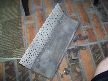

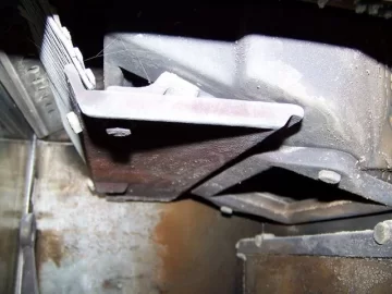

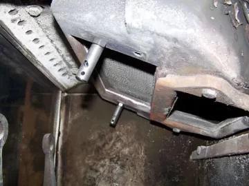

Woodstock has the new s/s replacement scoops for the Keystone and Palladian. Looks just like the Fireview's. Even though my old cast scoop is in good shape I went ahead and replaced it in the basement stove which has also has the s/s cat. The new scoop has a s/s mesh that wraps around the sides instead of the front only expanded metal old one. It's held in with some cotter keys and seems much easier to remove as well as light weight. I was told the new scoop keeps more fly ash from getting through to the cat and the new s/s cat has smaller holes than the ceramic cats so it should help keep it from clogging and less apt to warping.
Here are a few pics of the replacement.

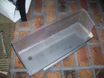

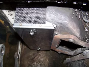

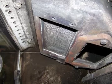

Pretty simple install, just remove a few screws, screw in the new post bolts and slip the scoop up into the groove.

I just did the same upgrade on my Fireview. The new scoop looks very similar to yours. I did have trouble getting the scoop up far enough to put clips on the pins. I ended up using a screw car jack to hold and push the scoop up into position
I'm quite interested to see if this new scoop & tighter screen make a difference in how clogged my stainless CAT gets. I was having trouble with maybe 10-20% of the holes being clogged last winter between cleanings. I was cleaning every cord or so. Maybe the almost 100% poplar resulted in more light ashes? This year will be 2-3 cord poplar and then switching to oak and other hardwoods for the cold months.
Yeah, they look about the same. Before I sold my Fireview I installed the new scoop. I screwed in those pins all the way and found out I had to back them out a bit to have enough room for the cotter keys. Did you back the pins out or screw them all the way in? You shouldn't need a jack to make it work.
I was told the screen has smaller holes than the s/s cat and anything passing through should not clog the cat. But they also told me to watch the screen for build up. I'm just going to use a grill wire brush to clean the screen if needed. I think this new system is a good mod that will extend the cat life and make maitenance a little easier.
I backed the pins out a turn or two but there just wasn't much leverage when working inside the stove. I didn't use much pressure; it just made the job much easier.
