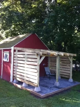

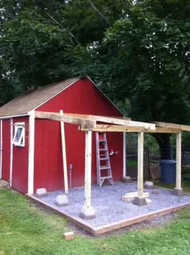

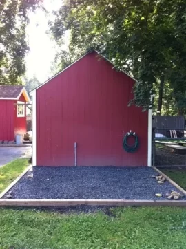

After a couple of weekends of work shoehorned around a vacation, the shed is 3/4 complete. All that remains is to slap on the roof and put in an partition wall - and fill it with wood, of course.
The shed portion is 8x12. I'm hoping it will hold about four cords stacked tight.
The photos show the prep work, the progress after the first day, and where I'm at as of this morning.

pretty slick woodshed!
i see a chiar in there. sure its not going to end up as a poker room?
Looking great
Should be ready for the wood soon.
Think how good it'll look when full of wood :)
The chair is there for the boss to sit in & watch ;)
I was thinking the same thing Tracker,,, I bet he sat back and admired his work for minute.
You nailed it. I plopped my butt down in there for 15 minutes after finishing.
