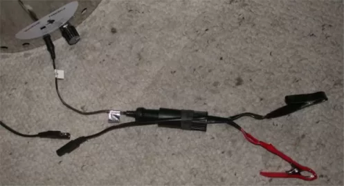

I recycled some parts from other projects. The clips photo. The battery clips come as part of solar panel kit. You need add a cigarette lighter socket. You will need to strip the wires back near the clips and solder wire to wire the clips are plated and will not take solder. I used heat shrik and tape to insulate. Then you will need a cigarette lighter plug to DC power coax connector. The one in the picture came from another kit I scrapped. There is a wire kit you can order from Woodgas web site, or just go to Radio Shack.
So you clip it onto a battery and put the panel in the sun. The stove fan will run faster on just the panel as voltage jumps to about 15 volts, clipped to battery its what ever the battery needs. In the power pack pic there is another extension cord set I made up. If there are ANY clouds or creeping shadows you want to run the fireplace on battery. With out the fan this is a smoke pot!!
