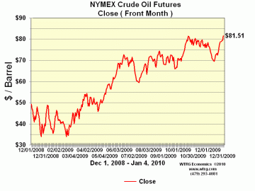

I bought all my wood at $250 per cord in Northern Worcester County late last year. He went up to $275 now. You have to shop around. Also, modern stoves are more like 75% efficiency. Oil closed at $82 per barrel today so burning wood is getting to be a better& better deal.

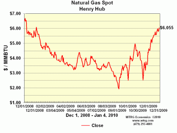

These two charts have a lot to do with how advantageous wood burning is:

Most people have no idea of the spot price of NG or the price ber barrel of oil. They 'see it' at the pump or when they get their monthly gas bill or go to pay the oil man. Energy prices have been rallying since late last year.
Don't worry. There is no inflation though. ;-)
