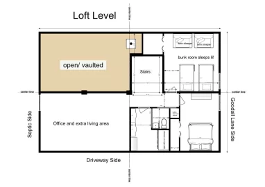

The cabin is 1350 ft2 main floor plus has a basement and loft with dormers. The ceilings are pretty high at around 11' on the main floor plus the stove will go in the living room with a vaulted ceiling up to around 25'. I will mostly be burning aspen, fir, spruce. We will have propane heat as well but want to heat as much as possible with the wood stove. I have a VC Encore that I installed last year in January and it works really well for our central Texas home. I also have some 6" chimney pipe on hand, so could save a few thousand dollars if I stay with a 6" pipe. Here are the stoves I am considering:

I am open to other suggestions, but really think a big firebox is important so I am leaning towards the BK KE40. I really like our VC Encore and the top load feature so wouldn't mind the Defiant at 3.2 cf firebox but i am afraid it will require more reloads than I prefer. I am burning aspen in our VC Encore right now and it is only getting around 8 hours of burn time before needing a reload. (Granted I have not had an entire season with this stove) I love the BK KE40 firebox size and reported burn times, but would need to go with 8" stove/chimney pipe. The stove prices are all within a few hundred dollars of each other so that is pretty much a wash. I don't have any experience with the PE non-cat stoves but they look good on brochure....but only a 3.0 cf firebox. The Lopi Liberty has a 3.65 cf firebox and can use a 6" pipe but is only rated at 70% efficiency for HHV and is my least favorite style (but still would be OK). I also priced out a Green Mountain 80, but it also requires a 8" exhaust pipe so I think the KE40 wins out between those two (except GM80 looks better) if I am going to 8" pipe.
