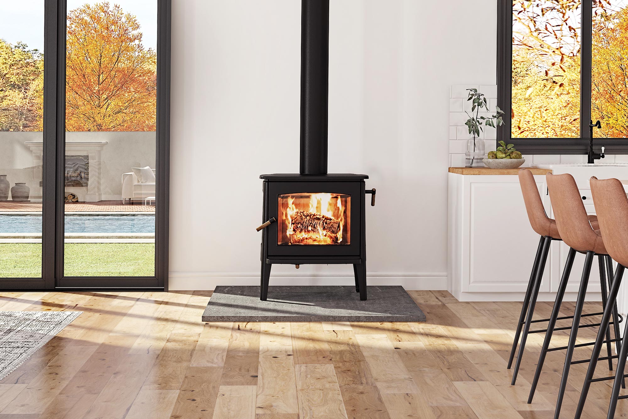

Are you talking about the ambiance hipster 14?
Reactions: WeavingRoots
Yes. Our local Hearth Store has one and we looked at them today.
I have never seen that before but it seems like it's made by hearthstone
