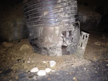

Took out the 'surround' facer piece surrounding the stove. It was "insulated" with some regular insulation, brick,mortor, and dirt....
Obviously a hack. The liner is definitley stainless though. Only problem is getting the liner to move from the stove. Cant get it out to fully pull the stove out.

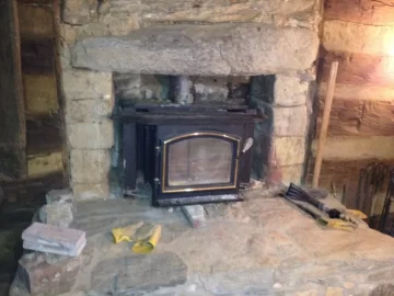

How about some pics?
[Hearth.com] Wood Stove on fireplace hearth Q's [Hearth.com] Wood Stove on fireplace hearth Q's
That looks like an older 3100i. Maybe you can confirm with the dimensions given here if you can't find a tag: (broken link removed to http://hearthnhome.com/downloads/installManuals/250_0640.pdf) Are the blowers missing or did you remove them?
Given the dirt on the top I assume the chimney lacks a block-off plate. Thus, a lot of your heat will go up the chimney and warm the great outdoors. I would also be a bit concerned about the integrity of your chimney. How does it hold up on the outside?
The liner seem to have a nut on the left and maybe other ones. Did you try to remove those before pulling on the liner?
Did you look in the insert whether it still has an intact baffle and the kaowool blanket on top of the burn tubes? (manual page 24) Without those the secondary combustion will not work and you will not get much heat.
There is no block off plate at all. The chimney is actually quite solid with no visible deterioration. Inside that I can get to right now feels solid as well.
The originals fans did not work at all. Bought some others, died within a few fires. I have some others in the mail, but my hopes aren't high. Any suggestions fan wise?? Most I've found are for the under the stove style.
The baffle and blanket are fully intact as are those tubes inside. That manual is definitely correct for my stove. Thank you so much!

Are you ordering fans from the manufacturer of the stove? Also, that is a heavy flex. It may take a lot to push it up enough to get the insert out. Also, want to be prepared for that flex dropping once it isn't sitting on the stove top. Unless you have inspected the stop of the chimney, no way to tell if it is secured properly. If that liner drops, it will cause a hell of a problem. That flex connector should just be sitting in the flue collar. Could be years of rust, and crap kind of have it stuck. You can work the edge of it with a thin flat bladed screw driver, wiggle it etc. Maybe have a 5 or 7 gallon bucket (upside down) on hand to slide under it as you pull the insert out. Wear heavy work gloves also.
