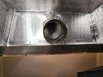

When I installed my insert, I used that foil faced Roxul on the back and sides of my fireplace, and I also made a blockoff plate above it with the same stuff. I bet this would help a lot if you have room to install it.
[Hearth.com] Wood Stove Insert Size
You can see that I also fully taped all the seams with foil tape as well.
