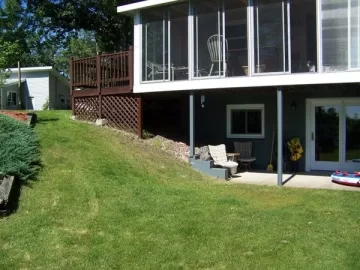

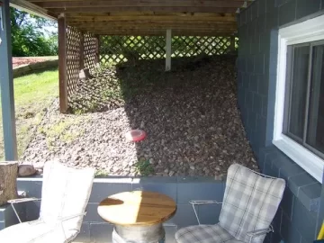

Good thread, I've been thinking of this for awhile. I need to build one so I can stop busting my ash with a full wheel barrow down my walkout basement slope. I was thinking of building a frame out of 2x6's and a slide with a 2' wide piece of metal roofing, and then put a box to catch the wood below my retaining wall.
