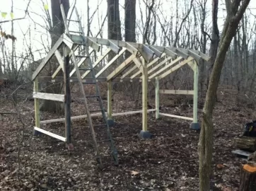

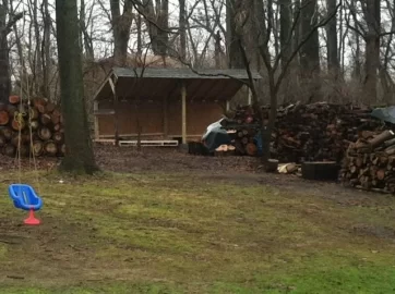

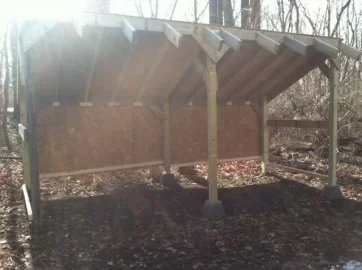

Wasn't planning on making a wood shed for a year or two, but Sandy provided much of the lumber I was able to recycle from the Jersey shore. So, I had at it. Did the best I could building solo. By no means perfect, not exactly square, but it will do the job. It is 16ft. wide, 6ft. deep, and ranges between 7 and 8 height at peak and 5ft. height along the back, with a 2 ft. overhang in the front. I still need to add sides, but I am going to begin filling today. Will post pics when filled.
