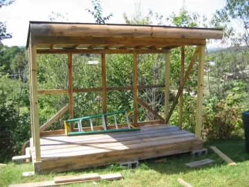

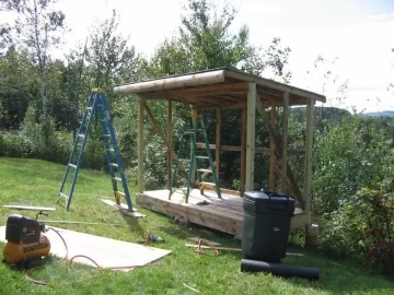

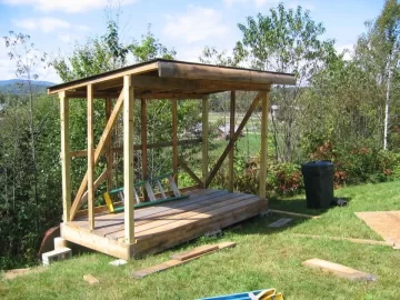

2x10" floor frame with 2x6 joists 14" on center with 2x10 flooring. Only the 4x4 posts, cement and 2 pieces of plywood were purchased and I need some T-111 (3 sheerts) for the back and some lattice for the sides. Should hold about 3 cord when stacked.
A few pics......I framed it to maximize floor space once I ate up space with the 4x4's being lag bolted into the framing.....and one random pic of the view from standing near the shed.......beacuse I had the damn picture....
