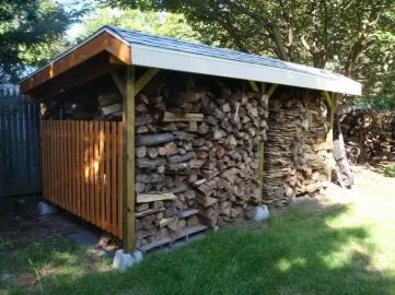

I built mine this spring for about $350,I went a little fancy and could have done it more basic for less money. Here is a pic of it with the trim unpainted.

$350? Holy smokes....that thing looks like it cost $1,000 all day long. Nice job...

very nice for 350. how muchwood does it hold? how well does it dry wood?

Thanks, thats just what I was talking about. I sat down and drew one out and it comes up to about $250, and it will look almost just like yours without the slant in the roof in the front.

I see you have used block at the corner posts , how did you tie it down so the wind doesn't lift it.
I thought of using those same blocks so the county can't call it a permanent structure and add 350.00 a year on my tax bill.
My shed holds well over 5 cords,and all sides are open to allow any wind to get to it,I made the roof overhang extend so nothing gets wet when it rains out, I even added a gutter so the rain splashing doesn't get on the wood and freeze in the winter. The blocks are working fine for me,the shed is usually full of wood so I can't see enough wind getting under it to lift it, besides it's quite heavy and should be able to withstand a severe storm without setting sail.

Very nice shed. Might I ask the dimensions? I'm looking to build something similar. I was thinking about making it lower, but then I think it would sprawl too much to get in the 4 cords of wood I'd like to store.
Thanks,
roof is 16' long x 9'ish wide over peak approx 8' h at peak I had some leftover roofing material left over from my house that saved me some $$ shingles are very expensive these days and I ended up using roll roofing in the back where I can't see it from my house!

I have a question about this type of shed. For the winter (or rain, for that matter), what do you do to protect the wood from snow? I could see it being blown in there or simply falling in there.
Is that an issue?
Snow is not an issue. Any snow that drifts in will sublimate.
I put a gutter on the front to protect the wood from rainwater splashing and freezing,I guess snow can drift up on it but I don't think it will be a big issue, certainly better than dealing with tarps and snowfall.
