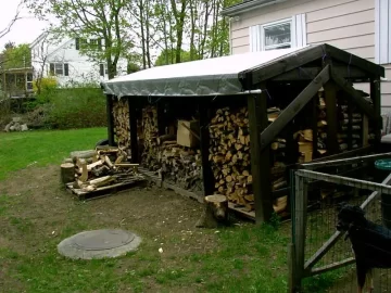

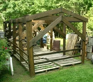

Here are a couple pics of mine, I just put the finishing touches on it recently. It was made with mostly recycled skids, with pallets for a floor. The Tarp roof is secured on the sides with sand filled PVC pipe. I figure I have about 4 cords in there now, should be plenty for next winter.

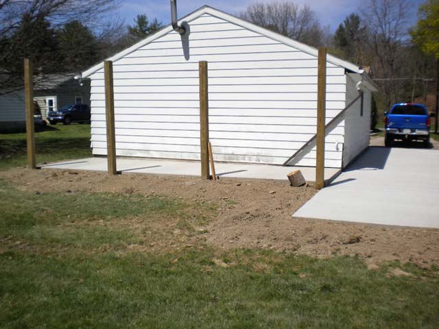

Heres mine B4 it was finished last fall. Holds about 5 cords

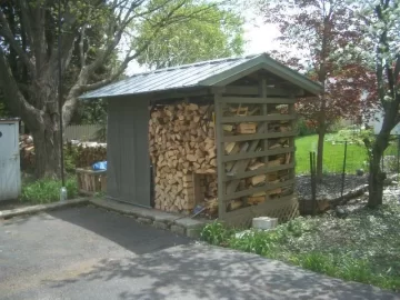

This is my shed. It's about 5 years old. If I would do it all over again, I'd go a bit bigger and use more posts sunk into the ground. This one holds about 3 cords, which is how much I hope to keep my total burning down to next year. 1/2 is full of ash and oak cut and split over the winter. I use the other 1/2 of it for summer storage of lawnmower, and other implements of destruction.
The decking is 2x6" over 2 x 10" joists. There is a sag in the middle of it after about 3 years. The only posts that go below our frost line are the 4 corners. The middle supports were really afterthoughts as I was building. What I'm most proud of is the roof. It's standing seam metal that a friend had left over from his house. Lead coated Stainless steel! It will outlast the rest of the shed (and me, and my house, and, and, and...)

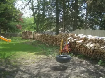

Last pix are of some other stacks I have. You can see my Holz Haus in the background.
