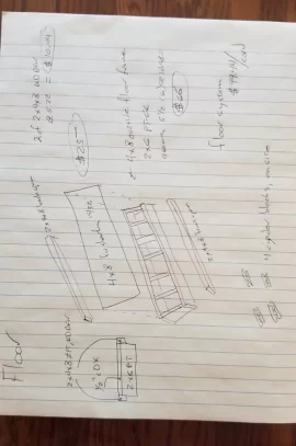

For the floor, imagine a complete 4x8 sheet of plywood, with the edge of a 2x4 flush with the plywood surface on both 8 foot edges. So the floor is eight feet long and 52" nominal (51 inches actual) deep. That allows a 1.5" air gap on the front and rear faces of the stack down the middle since I am planning to stack left to right in there. - no overhang out into the weather, standard 16 inch splits.
FWIW pricing is Fairbanks, AK, second highest cost of living in the USA after Honolulu, HI. I know a $100 floor for one cord is worth it. Mine have lasted five years and going strong with no more twisted ankles, and no more cussing about trapped feet.
