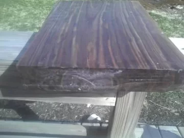

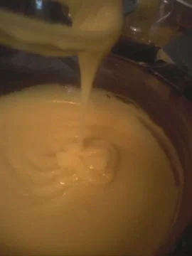

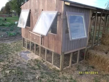

Those are some expensive finises mention. Very good products too. I am thinking if these tables are big rounds and out door tables, this could be a time to lay back off the expensive stuff. I would beewax it. Its clear will darken a little.

That wouldn't be a bad idea, but since the table tops are cross-cuts they are going to be very porous. I'd like to use several coats of marine varnish to fill up all the nooks and crannies and give a smooth surface. Marine varnish isn't a wallet killer like epoxy or resin *could* be.

Beewax works great sheds water like a duck! But would never be afraid to throw 20.00 at a top. (Never price Marine grade) Never had outside furniture I would even want to POP! lol
