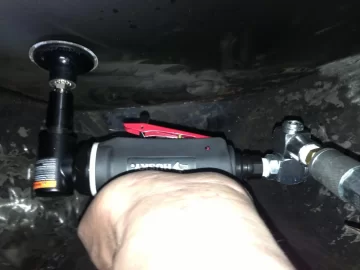

Cleaning it is a real challenge. So if you have a hopper like this and I hope not, this is what I did!
After vacuuming the pellets out, I tried a wire wheel and acetone but it was not enough to cut the mustard!

I tried a Husky straight die grinder but it would not fit into the hopper very well.
Finally I found a new smaller Husky right angle mini die grinder H4230 and kit of sanding disks for it at Home Depot! A 360 Deg NPT swivel for the tool fitting was also needed to keep the air house out of the way!
See > http://www.homedepot.com/p/Husky-1-4-in-Angle-Die-Grinder-H4230/203463410?keyword=H4230+Husky+die+grinder#.
That was the tool to that did the trick! After I got the hopper clean and smooth, the wire wheel cleaned up the corners and the Acetone cleaned up the shavings!
The VHT flame proof flat black was used on the bare metal as a primer coat. Then 2 coats of Stove Bright Satin black gave the hopper a nice smooth clean look!

Pic 5 - Tool of choice, the mini right angle die grinder

Pic 8 - Hopper clean and smooth but does not look pretty!
