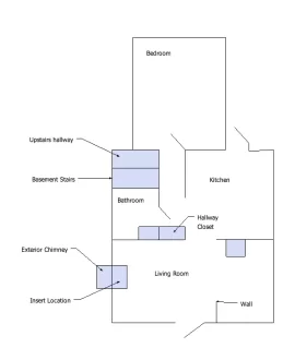

I've attached a diagram of our layout. When we moved in the house leaked a lot of air so we had the crawl space and the rim board sealed with spray foam insulation. I've added 2x8's to the ceiling joists above our bedroom before we had additional dense pack blown in and we're now about R-40 over the bedroom (attic over the bedroom isn't heated) and R-40 in the attic over the main part of the house. About 1/2 the ceiling surface area on the second floor only has R-12 because of the 2x4 rafters (it's a cape so the second floor has part of the roofline as the ceiling). The flat section of our ceiling (small attic space) over the upstairs bedrooms also has r-40 insulation. Needless to say, the house is better but still leaks a lot. We went from a drafty barn to just a regular inefficient house.
I've been quoted $1200 to rebuild the crown of the chimney, $2300 for a Pacific Energy Super Insert or a Kodiak 1700 Enviro, $750 for a liner (includes insulating the top and bottom of the flue), $800 for labor and another $800 if I choose to have the whole liner insulated between the flue and the outside of the liner. Basically I can pay $1200 to have my fireplace fixed so it's not leaking H2O or I can pay $3500 (with the tax credit and not including the flue liner insulation) and have a new, safe flue, a new insert, lower heating bills, keep the warmth from going up my chimney and a non leaking fireplace.
If we go ahead with this project then I plan on cutting out two vents in the living room ceiling for heat to flow into the upstairs, another vent with a fan will go between the living room and the downstairs hallway wall to move heated air into the bedroom and up the upstairs hallway.
Can you critique this proposal? Specifically, I'm wondering:

(The diagram only shows the first floor. The second floor is 1 bath and 2 bedrooms above the living room/kitchen/downstairs bathroom area)
