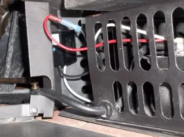

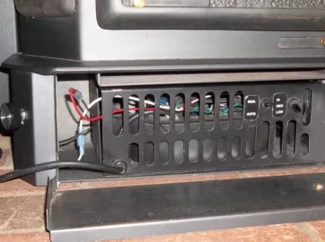

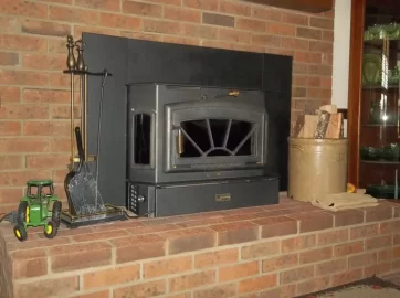

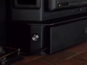

Here is a little adjustable fan speed add on I thought I would share with you. My stove is an insert which a fan on it is a must thing to have to move the heat. Has 3 speed manual or auto blower. Kinda loud even on low speed so I wanted slow it down alittle more. First I connected to the high side of the fan but still ran too loud even after you adjust the speed knob. Connected to the low side of fan and was perfect. No loud fan noise or even motor hum. Sure makes its nice when you don't have to turn up the tv to override the fan noise and didn't even hurt the looks of my stove. Very easy add on. Here are a few pictures of it.
