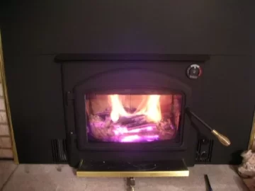

its a napolean 1101
I've been burning with the t-meter between 300-500, but I wonder what the temp is inside, and how much the fan affects it,
Here's a pic
  • [Hearth.com] wood insert ... burn temps and where'd you install a thermometer?
Read the manual, It states that the optimum burn temps (just below the trivet) should be between 500 and 600
