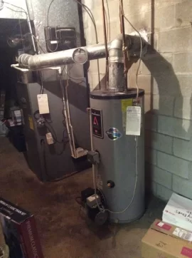

Prefab chimney with two flues. One goes to the main floor to a zero clearance firebox (currently has a gas insert....the gas tank was taken once it changed hands...was a rental tank). Second flue runs to my basement where it is hooked up to my forced air oil fired furnace and also the oil fired water heater (see picture below).

1) I'm not 100% sure what type of flue I have that is hooked up to my oil furnace/water heater. Do I need to replace the entire flue with Class A pipe or can I install an insulated liner down it and hook that up to the wood stove?
2) Can I power vent the oil furnace and water heater in one vent? Does anyone have an idea of what something like this should cost when hiring someone to do?
Please see the picture below for my current oil furnace and water heater.
