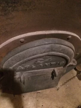

I've recently purchased a home which has an old wood furnace. I've never dealt with a wood furnace before but it seems pretty staiight forward and works well. The only issue I have is with the door on the furnace. There is no seal around the door just metal on metal when shut. There seems to be a large build up of tar looking creosote around the door, when the fire starts to cool down over the night and I go to open it in the morning the door sticks shut badly from this build up. Can anyone suggest a fix to this? From me yanking on the door as hard as I am I am scared the door will bust free from its latches. Which it is already getting a little sloppy in. Any suggested help or guidance here would be greatly appreciated.

Added some pictures of what I'm seeing.
The furnace is from the lunenburg foundry and engineering. Model # 24S-compact. I fought you'll find anything as that is from a small town in Nova Scotia Canada. Made in '86
I havent checked chimney since starting the fire 2 weeks ago but I have looked in the pipe from chimney to furnace and there is the start of a buildup of creosote.
That looks like it may be a boiler. Does this unit have air ducts? Looks normal if it is a 1986 boiler.
Ok. Furnace with a hot water coil it is. I bet if you put a small spacer so the air intake can't close all the way, it would help.

That hard glassy creosote around your door is more than likely forming up in the chimney too. Mine always did. The auto dampers are a nice convenience, but are just the best at making creosote form.
There likely was never a gasket on it, or it likely was never designed with one.
So, nature of the beast - but you should be able to limit its extent by making sure your wood is as dry as it can be, and not loading more wood in that should be loaded in for the particular heat demand at the time. Any time the damper closes with a fire going inside, it will start creosote forming. The more wood/fuel inside when that happens(amount of load), and the longer it stays closed (amount of heat demand)- the more creosote.
Might also be a possibility you might be able to reduce it some by unhooking that DHW coil & not using it anymore, but I suspect that is only playing a small part.

Concerning the creosote buildup on the door jam, it looks identical to the door jam on the Eko25 I heat with. Thanks to this site, I did not freak out over it as it has been stated to be standard conditions.
