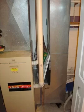

First off, you can't run the furnace into the return. The air is too hot, and you'll eventually ruin the blower motor in your LP furnace. The plenum, after the a-coil if you have a/c, is the best place for it. You can then run the blower on your LP furnace if you want to. You'll need a damper to prevent hot air from the wood furnace from backfeeding into the LP furnace. You also need to maintain a 2" clearance to combustibles on the hot air ductwork. These furnaces use a blower to move hot air away from the firebox and thru the ductwork, so in the event of a power outage, things get really hot really fast.

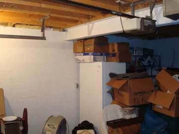

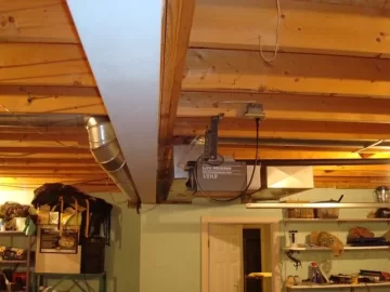

Anyway, here a few pics. The first is of my propane furnace with the A/C condensor. That unit is in the laundry room on the basement floor. The second is of the garage, which is also on the basment level and a straight shot through the joyces and drop ceiling to the furnace. Against the far wall in the garage is where I envision the furnace, which is the side wall of the house and is exposed for the top 4-5 feet of the wall. I also took a pic from the spot where I want ot install the furnace and looking upwards and at the vents. Keep in mind that this garage is roughly 30 degrees and two of the bedrooms are directly above the garage(you'll not there is no insulation and only the hardwood flooring on the joyces). Finally, factor that I am in the process of locking in a contractor tp finsh the garage and make it join the other side of the finished basement and opeingup the staircase.

Not to discourage any of this, but am I following that you are hoping to put a wood unit in the garage space that'll still be a garage?
If so, be aware that many building codes and/ or insurance companies won't accept a solid fuel appliance in a garage- the concern has to do with potential to risk ignition of fuel fumes from vehicles, power equipment, gas cans, etc.
No, the garage is actually being finished in mid february. The garage door will be pulled, blocked and a slider will be put in. The block walls will be insulated and dry walled. With the two main bedrooms right above the garage and there currently being no insulation under those hardwood floors, I imagine I am losing alot of heat from the upstairs right there. Anyway, imagine the garage finished with insulated, dry walled walls and ceiling(unless I do some type of drop ceiling)
