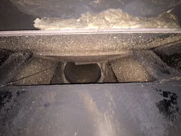

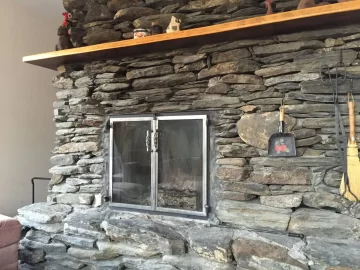

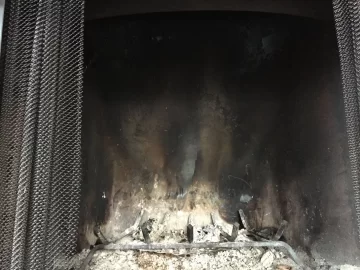

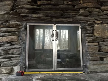

After buying a house, the last thing I thought would cause endless aggravation is a field stone fireplace. First problem discovered is that the chimney stack is to short, the fireplace is on the 2nd floor and in total the stack is 7' --- while the fireplace does work with clean fuel, this is less clearly than ideal. Less than perfect fuel and smoke comes into the house.
My plan was to have the fireplace chimney, either add 5' of steel exhaust to the existing chimney OR knock off the 2' of chimney above the roof line (yes, it is currently less than code height) and replace with 10' wood chaise chimney. Finish the project with a fireplace insert. But, I found out have steel walls inside the chimney (pictures attached). I'm assuming these are just a bad idea, perhaps corrosion or other issues. Perhaps my stone fireplace will become just stone at this rate.
I love having a wood fireplace, but I can not determine the best approach to salvage the fireplace. I'm hoping it doesn't require tearing the fireplace down. I've attached a few pictures, I'm hoping someone has some more specific ideas how to approach this problem.

That looks like a prefabricated steel fireplace and chimney system, with the stone for decoration. Which is a lot of stone, by the way. If it's on the second floor, what is supporting all that weight?
That looks like a heat form fire box in a masonry chimney with a liner in it. We need more pics and info to know for sure though but i am all but positive that is not a prefab
I'll have to look up what a heatform firebox is. The mason who last visited noted there are clay tile liners in the chimney. The front glass (you can't tell from the picture) is not attached to the steel box. So, if it is heat form fire box is that a bad thing? As note before, the weight of the stone is supported by cinder blocks and yes there is a full traditional damper system (damper is at top of chimney). Is a heat form fire box worth keeping? Can/should I switch to a fireplace insert if it is not desirable?
Heatforms are fine. Here's some information on them. If you want to improve heating then an insert will help, but most are going to want more chimney. You might be better off putting an insert in the downstairs fireplace instead.

Why not put a real insert (that is, a stove built to fit inside a fireplace) with a liner extending from the insert up and out the chimney at least another 8 ft. That will give you an efficient wood burning appliance and you won't have to worry about the steel liner in the existing chimney. By the way, I don't see a problem with steel - most new stove liners are stainless steel.
An insert will not address the short chimney issue. It looks to me like the fireplace has a stainless liner installed with a top sealing damper which there is nothing wrong with that setup but the chimney is still to short. And the liner also looks a little small which could aggravate the draft issue. I would have a sweep come out and look everything over and give you some options.
