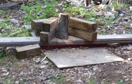

I used scrap lumber to make this. I bought bolts to fasten the 2x12s together and brackets to fasten the 6x6s on the sides. The plywood keeps me from burying the splitter in the rocky soil. By leaving a 6" gap where the angled 6x6s come together, I can place the spare 6x6 (on the left) upright between the two sides, to hold smaller pieces that would otherwise fall over backward.
P.S. Let me know if you need any rocks...I have 7 1/2 acres of them.
