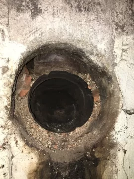

Here is a picture of where the stove pipe goes into the chimney and up. I should've clarified they are using single wall as a liner. The chimney is between 35 and 40ft. My $500 was an estimate. I'm seeing it closer to $700 for a new liner

Most liners are single wall. What I can see there does not look right it looks like an elbow at the bottom instead of a tee. But I can't tell is it is stainless or not because it is so dirty.
And $700 is really low for 35 to 40' I would be worried about the quality at that price. And I am sure insulation is not included in that price either.
So the liner is stainless. Did the old magnet test, so besides being really dirty I need to change the elbow to a tee? What is the reason for this? I don't really see an easy way for fixing that without making the hole in the existing masnoery chimney larger
So when stuff falls down in the liner it doesn't block it off right away the way it does with an elbow. And yes the easiest way to do it is to make the hole bigger.
