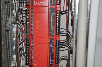

I have a honeywell L6006C I would like to use it to turn my DHW circ pump on .
the aquastat has a 3 terminals on it R-B-W
The controller is displayed below . Can any explain how to wire it.
Huff

rbw , you will only use 2 of those, 1 is for normally open and the other is for normally closed. Your pump will connect dirrectly to the DHW on the left side of that panel N & N/O line 3rd light down. pump done. now the aqua stat will connect to the DHW demand on the right side #9 & #10 . If you have any questions on the rbw it whould be on the inner cover and instructions. Use the N/O normally open when below 125 it will turn on, a L4080 does the same but it is only a N/O tstat

Thanx AL.185 , I wired the neutral to the neutral bus and the hot wire to the terminal below the N ,must be as you said N/O. on the demand side I wired the black to 9 and white to 10..
At the aquastat terminals . white on B and black on R.
