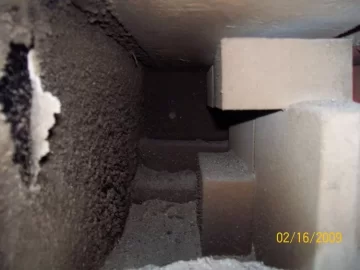

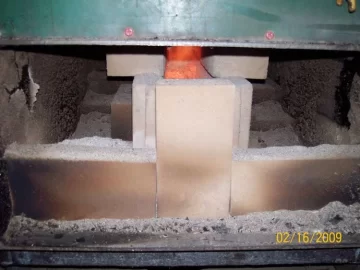

Barnartist,
I also have the 60 standard and can tell by my chimney temp gauge when cleaning is due..I was cleaning EKO every 2 to 3 weeks (without storage) to keep the chimney temps down..Now I am doing way better, like mentioned in the Boiler room(and when I talked to Zenon) I used two layers of fire brick right behind the rear U shaped block all the way across the back at the bottom of the exchangers, this stops most the heavier ash from getting into the exchangers and cut my cleaning schedual dramaticaly..I also get more complete gassification, I am still playing with other firebricks in the secondary chamber..I highly recamend trying this technique..Dave
TacoSteelerMan...I've looked and can't find the post your talking about so could you describe the firebricks a little more...are they laying flat like you would lay them in a wall or are they standing on the large end? This sounds like it could help with the cleaning issue.
Barnartist...I bought a 3 inch brush used for pellet stoves but the brushes are nylon. I'm not happy at all with its performance as the bristles are not stiff enough to scrape the tubes very well. What I've done is I'm using a 1 3/4 washer hooked to a dowel and scrapping the sides. I didn't get any tools with my boiler so I'm wondering if this like the clean-out tool your talking about. The scraping works allot better than the brush but a steel brush at the right size might just be the ticket.
The fire brick I've put in (longevity may be an issue, but not yet) lie length wise(side to side) horizontly across the boiler with one brick in each course lying front to back to fit with no cuts, much like buildings are built with a soilder brick course..This row of brick at the back of the bottom chamber forces the U shaped blocks forward towards the door, to channel the rear gassification nozzel forward I used two more bricks in the middle, on top of the wall, in a step position, to draw the flame forward, and pushed the U shaped blocks together..I am in the middle of trying stuff with the bricks as you see I am trying bricks on top of the U shaped blocks...Then I built a wall at the door using 3 bricks, two horizontel on each side and one in the middle vertically so it stands as high as the U shaped block but does not block air flow,this row sits at the point in the lower chamber where the refractory crete meets the steel at the door jam..See pics, excuse the ashes..Dave

Taco, keep up the good work. I'll wait to take advantage of your labors. Looks like your current configuration makes it tough to clean out the fly ash. Looks like you are getting great burns though. The way I am burning-using a timer as to leave good coals for the next burn- I get several handfulls of quarter/nickle sized coals left that fall through the nozzils to the bottom chamber. I scrape these into a pan and recycle. By doing this, and with a good burn practice, I only need to clean out the bottom of ash evry 3 weeks as compared to 5-6 days last season. But, this routine may also lead to some added tar buildup earlier than when burning to completion.
Having said that, I think there is a body of water under the bottom chamber. I wonder if keeping the ashes clear- and hey what if we elevated the U bricks but left an air pocket underneath? There must be some heat transfer to that water (maybe?)
