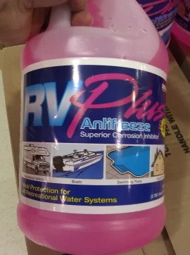

I was in Menard's today and I saw the RV stuff for $3/gallon. Any reason this can't be used in a boiler? It's soooooo much more affordable than any actual 'boiler' propylene glycol that I've seen. Pictures of the actual product attached.
I'm actually planning on running treated water this year regardless ... this is purely for curiosity's sake.

Would need the product MSDS to know... I'm guessing its the inhibitors.

My boiler is outside (CB Maxim), so I'd have to get ~33 gallons if I wanted freeze protection down to 0f. That would cost me more like $700 from what I've seen. I think I found the MSDS for the menards stuff, and I think it has ethanol in it, even though it's not listed on the bottle ... so that's probably how they can sell it so cheap :(

The glycol used for closed loop hydronic systems has special buffer components. Both PG and EG are used in boilers, EG is a bit more toxic, but lower cost. EG is commonly used in larger commercial systems where it cannot come in contact with domestic water.
Either PG or EG can be recycled. They allow it to settle out run it thru multiple filters, finally an RO then they re-buffer and add color back into it. Many automotive suppliers sell re-pourposed glycol. PG and EG can be mixed as some cars now come with PG antifreeze. When it is drained it goes into the same recycle barrels at the Lube Shops.
Automotive glycols contain silicates and will sludge up hydronic pumps, boilers, valves, etc after time. Not a wise idea to use automotive glycol in hydronics. It will reduce heat transfer as soon as it is added and starts coating your boiler with silicate gel.
Hydronic glycols contain many buffers, which is why they cost more. Special glycols have been produced to work in systems with aluminum and these contain 20 or more ingredients.
Hydronic and solar glycols are buffered for PH, hardness, they include oxygen scavangers, disperants and film providers. Dow adds a patented additive they protects the fluid if it is mixed with hard water instaed of the required DI or DM de-mineralized water.
RV antifreeze is pretty much a food grade PG with some coloring, not much in it to protect you hydronic investment.
Read the label carefully, some RV antifreeze is menthol based, and flammable. Glycol is non-flammable in solution up to 80%.
