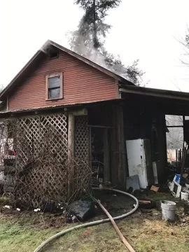

A structure fire this early AM. A good reminder why we line our chimneys and proper safe burning practices.
![[Hearth.com] Why line the chimney? [Hearth.com] Why line the chimney?](https://www.hearth.com/talk/data/attachments/194/194657-185b74949bf0e707ead7365758a8ab46.jpg?hash=3oiR7K-1DM)

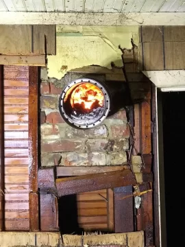

The fire took 2 hours to extinguish and caused about 30k in damage to the structure. My biggest takeaway is obviously the serious amount of creosote burning inside that chimney, and, the obvious improper clearance to combustibles for the masonry chimney. The fire spread to the surrounding structure and ignited it.
Money on an insulated liner is well spent. In my previous home my installer didn't insulate the liner, said it would be fine... I won't do that again. Insulation always.
