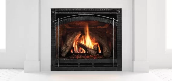

I believe this is a gas fireplace - does anyone know the model/ mfg. Thanks

I'm not sure, but if that front in removed (it likely hooks onto the face somehow), there should be an appliance rating label in that area under the firebox. That'll be the best way to be certain...

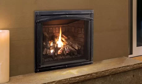

The Log Set and face kind of looks like An Enviro Q2 model with a forgeworks face, but it's not quite an exact match. That big back log really does look like the one from the old Enviro basic (Q2/3 & E Series) log set (was changed in roughly 2019).
This is the Enviro Q2 next to the heat n glo 6000clx with the chateau forge front which is what nvr_enuf is showing.

All good. We had a 6000clx with the same front in showroom for years. after seeing the thing nearly every day for years on end i hardly had to look at the picture.
