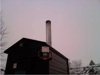

Just to ad my two cents worth in here...I have an empyer pro 200 gasser and couldnt be happier with it...and the learning curve verse a nongasser didnt take long...profab is a good company any questions that i've had they always been there and quick to call when i've had to leave a mess. and look at the pro400 that has the heat range for the sq you said that you were looking to heat. I unlike many others on this site dont like the wood inside and with my unit only yards from my wood pile makes it super nice. and for the sq footage that i heat 2200 old house and another 2200 for the attached garage with the heat kept inside at 75 and garage kept above freezing unless i'm out there workin in which its 50-55 with exchanger on usage seems pretty small somewhere around 6-7.5 cords nice seasoned wood. The main thing is support, go with the company that you feel give you the best support. priceless
Pictures, or it didn't happen
pictures of what? the install? I do have a thread on arboristsite.com i'm under the same name as here. I did a lot of picture install pics. of the unit the trench i dug for the cheaper pex lines that on a 100ft run i only loose one degree of heat from the burner to the house which alot of people say it cant be done but proof is in the pudding, i dont have anything against the expensive thermo pex you prob. should use it if you dont have the ability to bury your lines deep mine are at least 50" deep...Also on the other site i've got a log on usage non-bias of my burner, that someone will and should expect the same issues that i had to deal with. And like i said on the previous post support is the main thing...dont really care what burner this gentleman goes with all i can do is tell em about my experience of what i got. If you dont have a company willing to stand behind there product and willing to help when you hit a bump in the road and you will theres no doubt about that it is all pointless...I should also mention that the reason that i went with Empyer is that my neighbor has an older unit that is not a gasser, I could of went with a unit like his and saved over 3grand but due to how the house are set up around us i thought that 2 of those smoke dragons side by side would cause a little uproar, so i choose to run with the phase 2 cert. gasser and boy am i glad that i did, but the neighbor had his unit for 4 yrs. before i got mine and had nothin but praise for the Profab company...I could of went with a CB and there just down the road from me but choose not to due to the troubles and hickups others were having with there E series gassers...But i suppose i can post pics here, i'll try to figure it out...also if you notice in the clean burn pic i circled the light to show its in full burn with no smoke outta the stack. hope ya believe now...lol and dont mind all the pics...Hoogie
  • Who has a wood Doctor OWB
