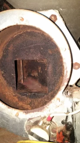

Here is an image of the exhaust vent with the combustion fan removed, as far as I can tell all four seams of the exhaust tube are formed or welded. Also is the rotating shaft that the damper plate was attached to.
Maybe I can retrofit a sliding damper.
Thank you for your feedback.

I believe the damper needs to be in the exhaust for some back pressure, my auger was running at full speed yet the circulation air temperature was not real hot. I expect that the efficiency was way down while I was heating the back yard.
I will definitely touch base the pellet head people to see if they can help.
They may be my best option right now.
