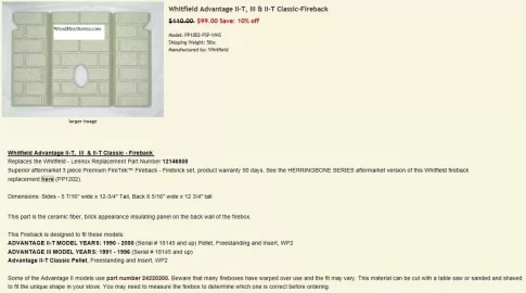

WoodHeatStoves has it listed on their website and even at 10% off http://woodheatstoves.com/whitfield-advantage-iit-iii-iit-classicfireback-p-359.html?cPath=95_207
Whitfield Advantage IIT firebrick
That is the aftermarket vermiculite panels that he was unhappy with the performance on.
Oops, you're right... it says: 'Superior aftermarket 3 piece Premium FireTek™ Fireback', well I guess Pellet-King won't agree with the word 'Superior':(
This should be the OEM Lennox Replacement Part. A little more expensive $119,-
http://rockymountainstove.com/whitfield12146500advantageii-tfirebrick.aspx
Maybe it's the photo, but to me the vermiculite appears more glossy on the surface than the cera-material??
