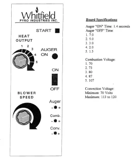

I have almost the identical problem with my Whitfield Advantage of the same era. Under which of the silver caps is the exhaust blower trim?

Reactions: Dirtbiker and Ssyko
