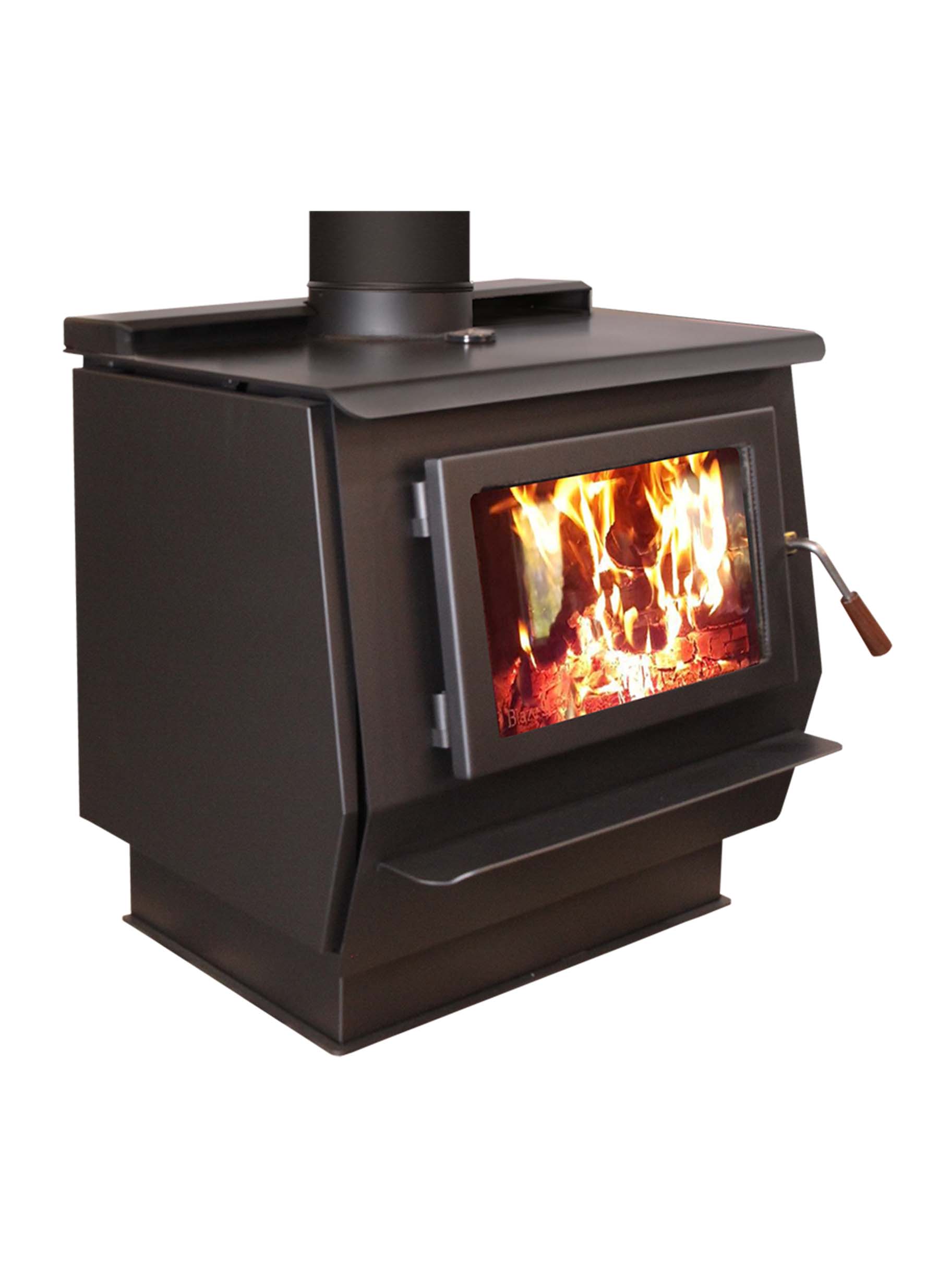

King 40 - Blaze King
At 81% efficiency the King is the most efficient wood stove in the world. This allows you to get the most heat out of your wood to reduce your heating costs. The King has the largest and deepest firebox of any stove on the market and is for serious wood burners. This stove is great for families...
