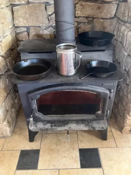

Is this a very old or newer Lopi? Please post a picture of the Lopi so we can get a sense of what is currently in place and then make suggestions.
Reactions: bholler
The chimney is maybe 25'+. Pictures of the Lopi are attached. We will probably keep this but need an insert for the other house.

The Liberty is a good, clean-burning stove. If creosote is accumuating, it's likely due to how the stove is run. This could be the fire being choked down too soon or poorly seasoned wood. One thing that will help is to change the single-wall stove pipe to double-walled. That will keep the flue gases hotter. Then add a probe thermometer to the new stove pipe to track flue temps. Keep them above 350º until the coaling stage of the fire.
