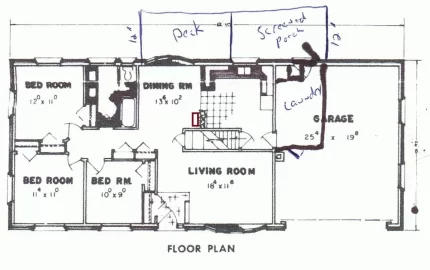

Attached is a pic of the floor plan (not to spec). I have very few options on were to put this thing as the house is already WAY small. I have a narrow space between the dining room and the kitchen were there is a room divider now/ I am thinking about this space. See the Red Square on the pic. I am thinking that the stove could go here facing the hallway and bedrooms. It is relatively the center of the house with a large access way to the living room nearby. The space that I have is 30 inches (where the chairs are in other pics) by 48 inches (length of room divider) The dining room has a large 8ft sliding glass door, that I am concerned about losing heat to with a radiant stove. Any thoughts on placement?
