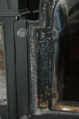

Which gasket should I replace? (pics)
Diabel
Jan 11, 2008
3,862
Ottawa, ON
I just noticed this nasty stuff :gulp:
Also, should the glass have any play in it as I push on it with my finger?
The window gasket on my stove (also VC/DW) was the first to fail (and be replaced). When you do replace it, be advised it is a smaller gasket than most of the others on the stove, such as the door gasket just a few inches away. Good news is that its very easy to replace.
Its a 3/16" gasket. You can get the kit from VC for it, its a #0003427

So I took out the glass from the doors & the old gasket just came out, it was not cemented at all, not even in spots. Should I apply a bit of silicone or cement to the new gaskets?
Thanks
Done! Replaced the the glass door gaskets..piece of cake. Replaced the griddle gasket..piece of cake. The glass door gasket still looked in a decent shape, just flat & surprisingly not glued anywhere. The wire mesh griddle gasket looked beat up strangely after two seasons!
I also noticed that the ash pan door (replaced gasket last year) in the top hinge side corner was a bit black, I'm assuming it is leaking air a bit. I loosened the top two bolts that hold the door & repositioned them a bit. I will keep an eye on it. Hopefully I didn't make it worse.
