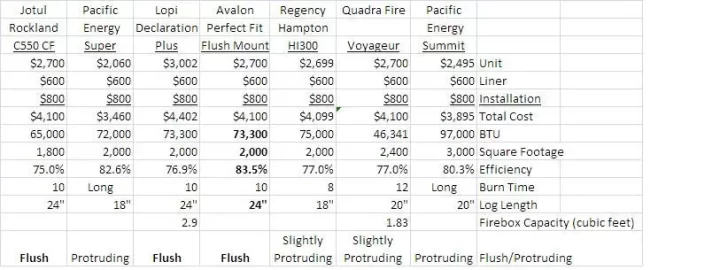

If you could offer any insight into which unit would offer the most heat and longest burn times based on experience, I would appreciate. Also any insight into the numbers would be helpful, example would be why would they list the Quadra Fire as being able to heat 2,400 square feet but only but out 46,000 BTU’s? Should I disregard the BTU and efficiency numbers and look specifically at Log length and firebox capacity? Any insight would be greatly appreciated. Spreadsheet below is something I put together to help compare. Sorry, its a bit of an eye sore.
