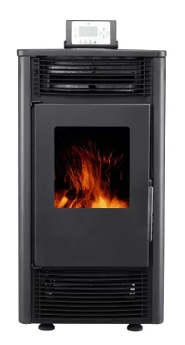

Any ideas about the Fire Flame 'Blue Ridge' stove? I am sure it is a branded China made stove also.
