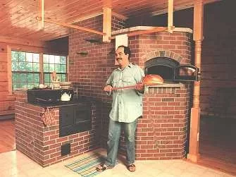

Off-grid, well insulated, hmmm. A small masonry heater could be built such that it has a cook stove on one side, an oven on another side, and a glass door on another side. The masons would just alter the channels around so they would flow under the cook top. In Europe and northern Asia this is a common appliance. You could even make a fourth side into a bed area. That is you would just have a big bench.
Maybe like this but smaller. (There is a glass door on the unseen side.)
